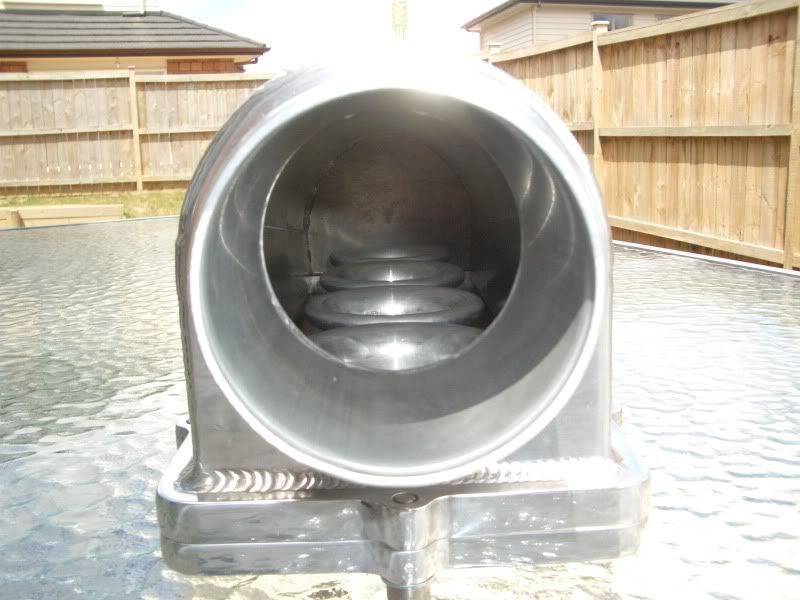

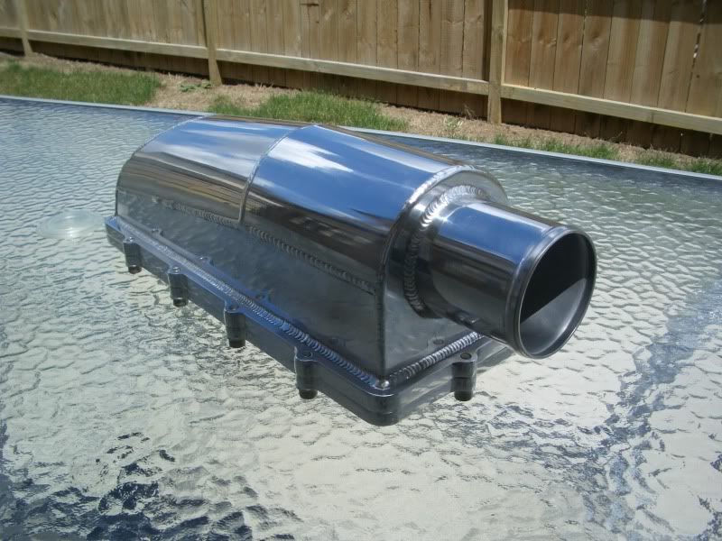

This plenum could be of help.

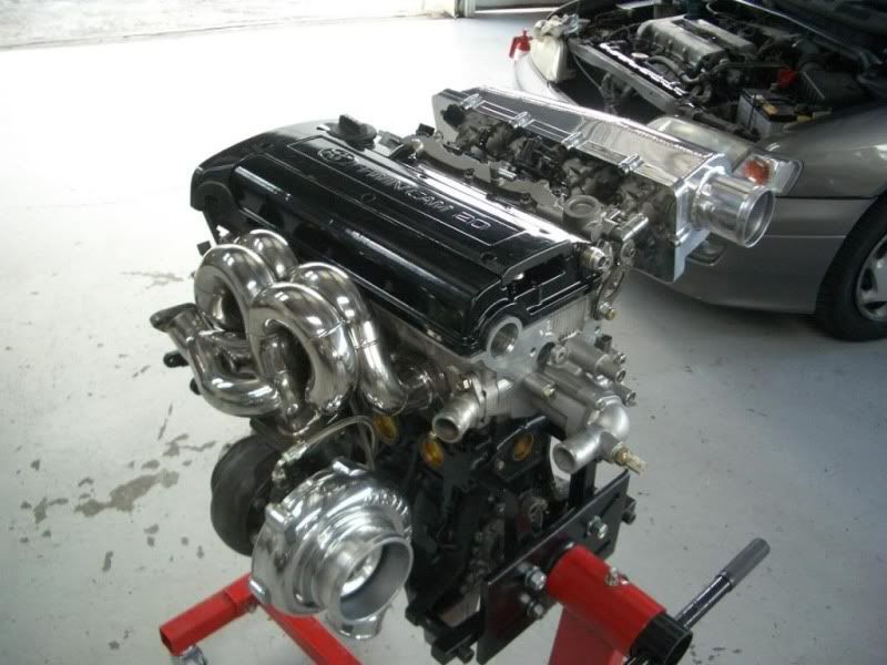

seems to have good gains more on the n/a motor than FI.
Think ke25sr off here was running open trumpets, changed to this and gained a heap more power. Something like 30hp atw along with some other mods.
I guy with a stock silvertop just with exhaust, this plenum and pod in the guard got me to make him one, auto ST as well!!! it made nearly 100kw atw!!! I coulndt beleive it but thats what the dyno read at ST Hitec.
In FI form from having no trumpets just a plenum box, its gained more torque and hp, but not by heaps but enough to have a gain over the whole rev range. It brings the peak power in earlier and holds that power with no real drop till red line.
Trumpet lenghts can be made up to 70mm.

Postby Bazda » Mon Mar 01, 2010 7:22 am
yes I made that one.
I will most likely be getting one tested out on a BT soon. but its not stock.
I can get dyno sheets for the ST that was run.
I do have dyno sheets for the FI one that made 358kw atw.

As for expensive, to buy a set of bell mouths to the quality the ones used in these would cost you around $300.
In fact for the cost of materials, welding, and labour put into this, they should be ALOT more in price.
Plenum - A space where the air velocity is reduced so as to eliminate turbulent airflow prior to being smoothed and accelerated down the velocity stacks.
Airboxes need to be well-sealed and stiff in construction to maintain resonance characteristics. A simple way to illustrate this is to blow across the mouth of an empty bottle. The sound you hear is the natural frequency of a Hemholtz resonator.
