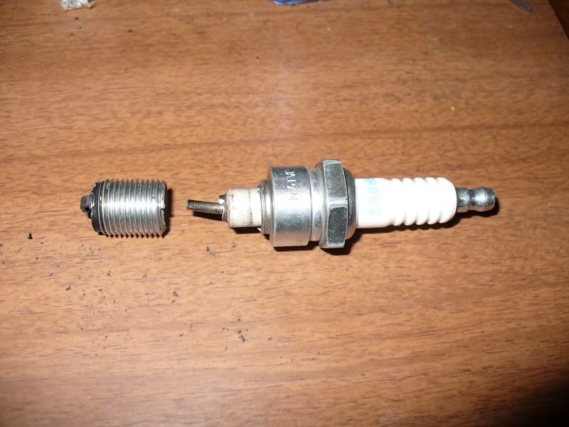

Postby Burning Angel » Tue Mar 02, 2010 5:43 pm
like this?
or was it all burnt and melted looking with ground electrode missing.
im gonna say you had a pretty serious case of detonation, that'll fry plugs in no time.
i wouldnt bother with platinums either, mainly 'cuz theyre real expensive to blow up. standard densos or ngk would be fine.

Postby AE86fan » Wed Mar 03, 2010 8:42 am
Looks like the 'pre-ignition' one in the photo just a bit worse, with no ceramic stuff left at all on one of them and a small bit of electrode.
Burning Angel, How did you manage to snap that plug in two??

Postby Burning Angel » Wed Mar 03, 2010 9:14 am
I didn't snap it, it was out of a customers car.
At first i thought he'd over tightened it but if you look at the fracture theres no twisting.
he said he was driving along and there was a big bang, plug had gone through the sparkplug cover and made a dint in the bonnet.

Postby BlakeNZ » Wed Mar 03, 2010 10:12 am
Almost certainly a severe case of detonation. When it is this bad, you normally have ring land damage or even melted a hole in the piston. So you are fortunate the compression test came up well. Broken bits will have been blown out the exhaust valves by now i reckon, so put in some normal plugs,and sort out your timing issues. Platinum plugs are more prone to detonation(IMHO) due to the tip retaining heat.
