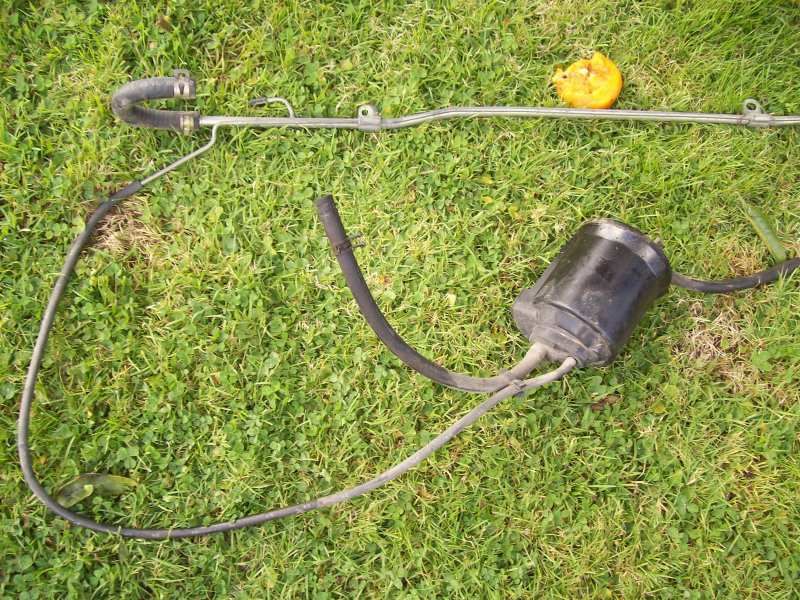

OK, the charcoal canister has two lines going to it. one is vacuum source and the other is to the fuel tank.
Do i need to run a charcoal canister? if not how should i delete it?
Should i just leave the fuel tank line vented in the engine bay? or should i delete it further back and just have it vented? or should i block the end?

See pic of stock set up, although i guess im not running stock n/a 5mge anymore.
