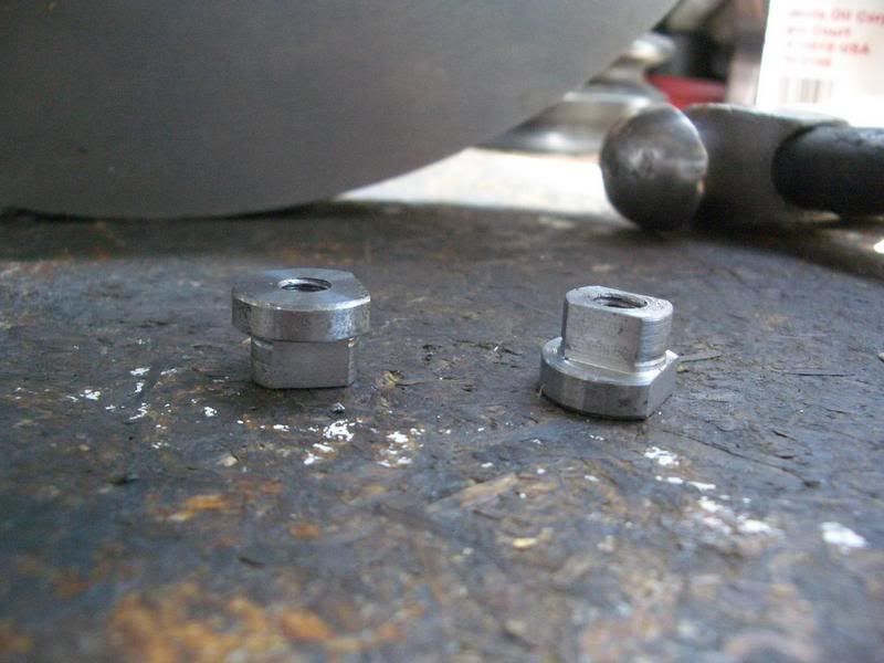

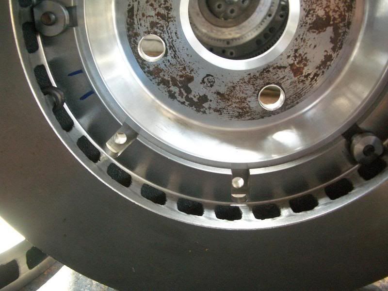

A 2 piece disc I have used, to make them work well they need to made full floating. So the hat taht you make can expand and not rip the disc apart where its bolted.
My first set were solidly bolted to the disc and it cracked around all the bolting point, so I had to get the guy who made them to make these tiny spaces that actually lift the hat off the disc XX thou so its actually a tiny bit loose.
Nice light discs at the end of the day but a hastle when you have to replace them disc as you need to CNC all the holes etc again.

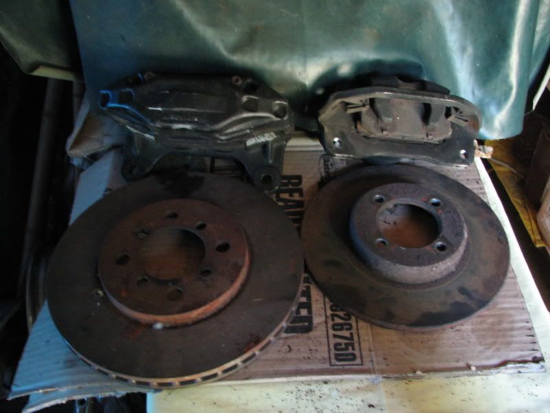

Also you might encounter the caliper hitting the inside hub as the calipers are wide just like the pads. From looking at the pic of ST205 front brakes I dont think you could go down to 280mm....unless you had a smaller hub...
