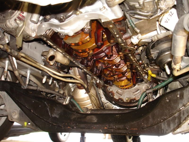

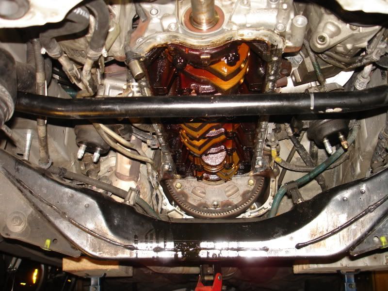

Postby Jason T » Tue Mar 30, 2010 11:41 pm
You need to get sub frame low enough to remove sump only
Have look here
http://www.clublexus.com/forums/gs-second-generation/475133-2jz-gte-jzs161-oil-pump-and-rod-bearing-replacement-in-vehicle.html
Rent a engine brace
Seals were in stock when I replaced my oil pump I can help with replacments if Toyota dont have
