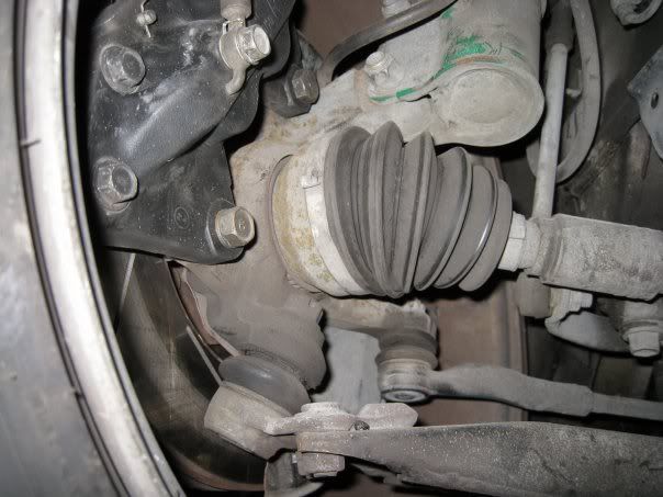

Trying to figure out what hub this is..
I think its off a celica?? but not sure which model...
Postby TRD Man » Mon Apr 26, 2010 12:11 am
Looks like one you might get off an ST182. Or SS1 ST202. The rotor's obviously not std and I suspect the caliper is not also.

why do you think it is off a celica? GT4 calipers bolt straight onto corolla hubs. Does it no longer have the factory drive flange?
Postby Bazda » Mon Apr 26, 2010 8:18 am
I found out its a ZZT231 celica hub with ST205 calipers and Mercedes 300mm discs.
Anyone know where I can get one of these hubs?
Postby TRD Man » Mon Apr 26, 2010 11:04 am
The Head boys (Toyota Wreckers), in Lower Hutt, have had a few of those Celicas. Might be worth a call if you can't find anything closer. 04 5865664

I suspect those discs are the type i'm currently trying to find.

Or you could use the ST205 disc and machine them down. But on some hubs the disc may hit the ball joint.
Managed to find some of these hubs at a local wrecker.
