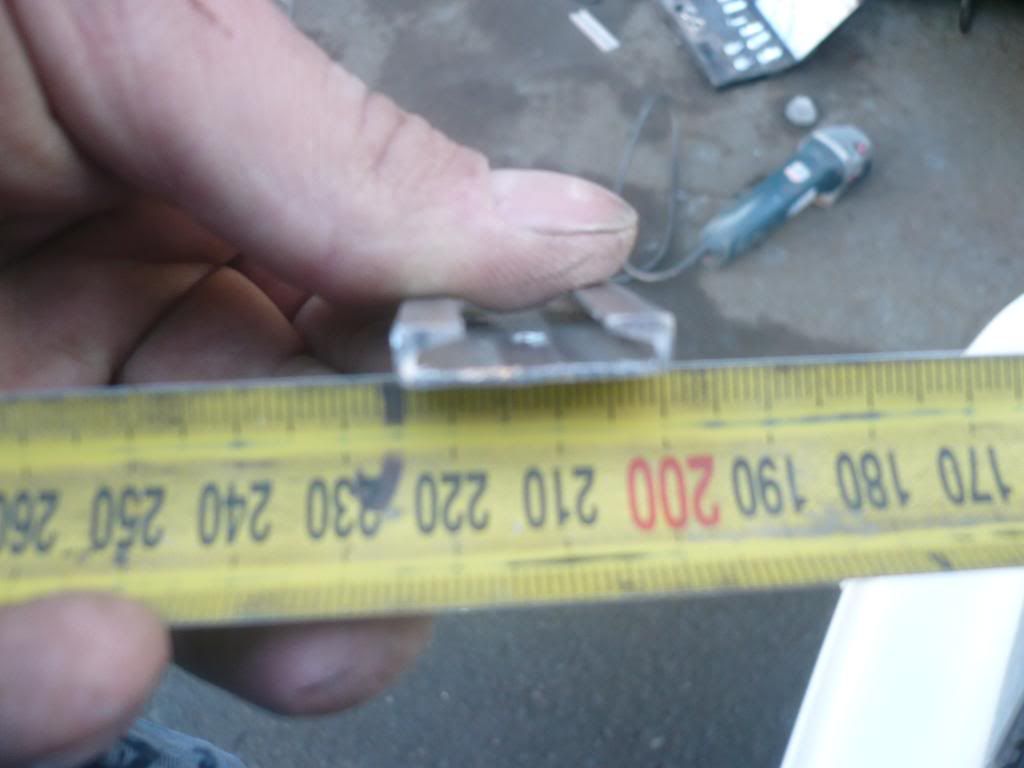

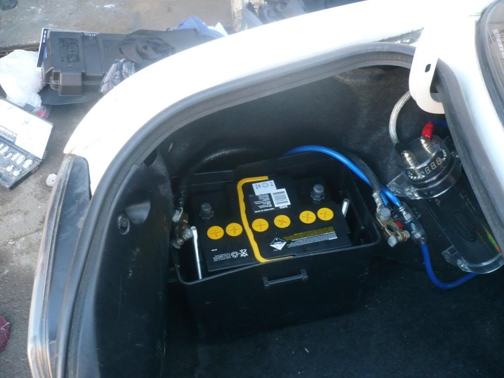

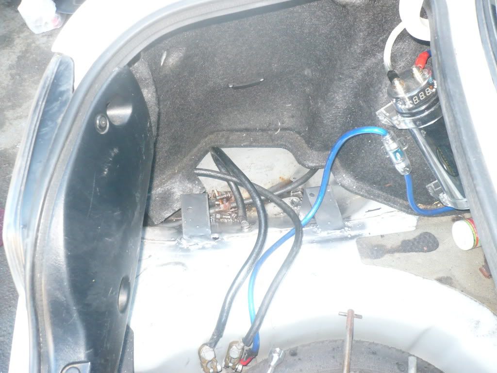

Postby Stott69 » Sun Jun 06, 2010 6:26 pm
Some of the pics of what Ive done, am I taking the right approach?
Welded in brackets for the battery to sit on and rods to bolt to, 2mm steel
What Im useing for the clamp
Battery in place with m10 rod for clamping

Postby gurutasker » Sun Jun 06, 2010 6:36 pm
matt dunn wrote:If it is in the boot, and the boot is sealed from the cabin, (i'e 4dr sedan)
then the box does not need to be sealed.
But if the boot is unsealed,( i.e. FXGT or 3dr Hatch)
then the box must be sealed and vented.
Note: not all 4-dr sedans have a sealed boot.
Taking a quick look at the photos have you got:
"with under floor counter plates".
These can be as simple as some large flat washers.
there is no specification listed AFAIK for the size of the straps, however because you are using steel, you will need to find a way to insulate it. (I've got plastic tube over mine, if you end up coming over tomorrow you will see).
The ventilation is a requirement, as it is a sealed box it needs to be able to breathe in case of a spill or any other leak.

Postby Stott69 » Sun Jun 06, 2010 6:47 pm
Ive also made up a markI rubber cover for the positive terminal, surely the negative one wont need one

Postby gurutasker » Sun Jun 06, 2010 6:48 pm
Stott69 wrote:Ive also made up a markI rubber cover for the positive terminal, surely the negative one wont need one
Correct.
