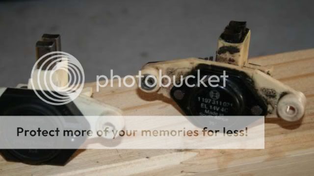

I found this picture
Will measure 17~ volts without regulator
If it's looking anything like that then it needs to be replaced and should fix your problem

cat007 wrote:Thank you for that. Where would that be located do you think?
By looking at pic, it should be on the alternator, on a side, close to back side, since there are brushes sticking out of the thing.

Postby matt dunn » Sat Jun 05, 2010 6:57 pm
I would place a bet that your regulator will not look anything like that,
unless your van is Australian assembled.
that is a Boch type reg and are classed as an internal regulator,
as it is part of the alternator.
You will be looking for a much larger metal box,
like 5 cigarette packets on top of each other size,
probably behind the glove box.
Or it may be an actual internal regulated alt, and it needs to be disassembled to get to the regulator,
But since you got it wet and it stopped,
my bet would be a fault in the alt. not the reg,
but all guesswork at this stage.
