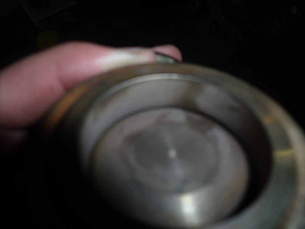

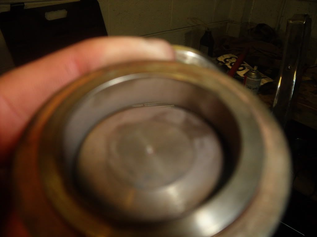

so after FINALLY taking my car for its maiden thrash at the track after rebuilding it, I decided to remove the boost controller and just put the appropriate spring rate springs in the wastegate, as i noticed some weird things happening on the gauge. (was peaking then dropping back to spring press (10psi) rather than boost controller press (14psi))
so after much pissing about i got the wastegate off (which is a Tial 38mm V band new type one) I noticed on the exhaust side the piston type thing doesnt seat perfectly on the housing, which i would assune would be essentially a permant exhaust leak???
is this normal????

Postby matt dunn » Wed Jun 30, 2010 11:35 pm
All the ones ive seen including my Tial one,
have a removable seat that the gate seals on,
and it falls out easily every time you pull it off.
Your pictures are not that great, but it looks like the actual seat is missing?
edit: not a genuine one but this picture shows the seat in the back at the top.
http://www.trademe.co.nz/Trade-Me-Motor ... 461179.htm

Yeah there's supposed to be a seat there....

Postby CAMB01 » Thu Jul 01, 2010 12:10 am
The seat is there in your pictures.
When you fit the wastegate at least with the 2 bolt style ones, the seat gets pushed in up against the valve and seals it. Not sure how it works with the clamp type, im assuming the same way.

Postby d1 mule » Thu Jul 01, 2010 12:29 am
crisis overted, thanks CAMB01, gave the seat i tap with harry the hammer and all was sorted.
thanks heaps guys
