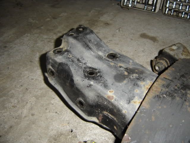

Postby Coldspark » Fri Jul 09, 2010 7:50 pm
from my celica xx
the last owner replace it, with something he doesn't know
Im assuming F series?
oh allso its not lsd

Postby deaf_rattle » Fri Jul 09, 2010 7:56 pm
assuming he hasnt done anything silly like replace it with a t series diff it should be an f series.
Unfortunately the best way to tell the ratio is by taking the backing plate off and doing a tooth count.
LSD will have lsd oil sticker on the right hand side fin, this doesnt come off very easily, but can be covered in years of crud.

Postby KinLoud » Fri Jul 09, 2010 8:51 pm
The subframe looks a lot one I modified.
The extra holes are so an F series diff will fit into a T series subframe (or vice versa).
Can't quite tell if it is a T or an F series diff. A better pic of the rear cover would be good.

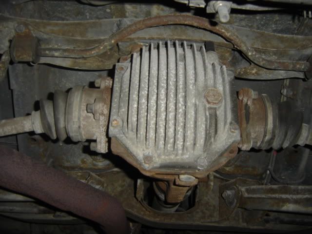

Postby Coldspark » Fri Jul 09, 2010 9:03 pm
As requested

Postby Zestripper » Fri Jul 09, 2010 9:32 pm
That's a t series. Only 3 bolts on top and the backing plate is the same as a t series I have laying around here. Also being a 1g-eu usually means a t series rear end. What does the engine bay build plate say?

Postby Coldspark » Fri Jul 09, 2010 10:24 pm
TRANS / AXLE a42dl t282
i did check that first but though it could be wrong has he has replace it and hows it manual aswell
so if i say 1jz-ge and this diff = NO!!!

Postby Zestripper » Fri Jul 09, 2010 11:06 pm
It's likely the car has been converted to manual at some stage. Might have an interesting history to it? A lot can happen in the 25 years + since the car left the Toyota factory. Since your subframe is out of the car it's pretty easy to replace with a f series subframe and diff. Here's a couple of F series pics for reference anyway:
And yeah, 1jz + t series = not for long
