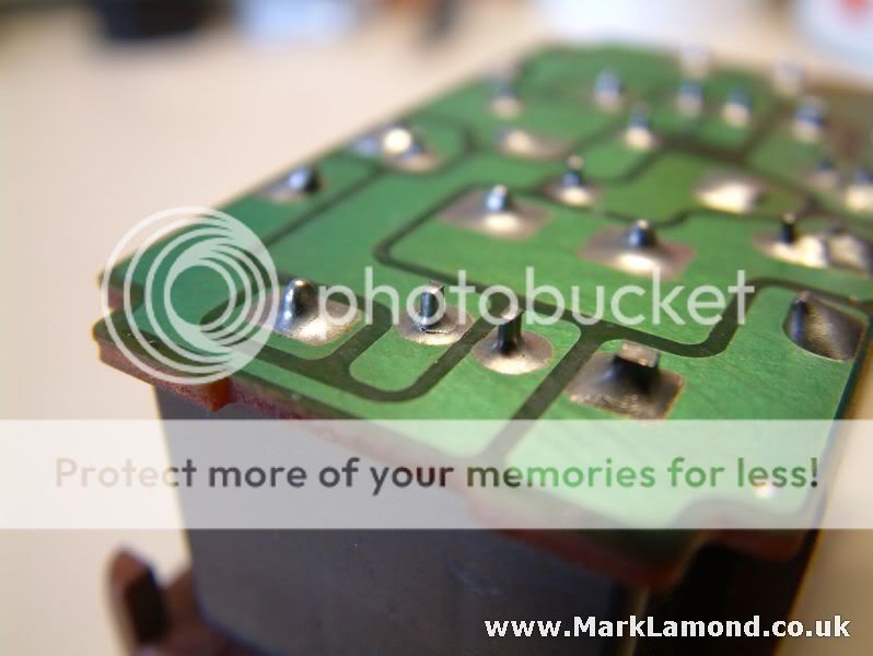

Postby RobertC » Tue Jul 27, 2010 11:32 pm
sounds like what was happening in my levin. Pull apart the controller. (the bit with the buttons and sliders. and on the circuit board there are probably some dry soldier joints. So just go over the whole board with the soldering iron and add a bit more soldier to each of the joints.
This is what dry soldier looks like.

Postby Levin_it » Tue Jul 27, 2010 11:43 pm
The dry one being the second from the left in focus? yea I can see how that's uncool. Did you re soldier your circuits and fix the issue or is this what you are currently doing?

Postby RobertC » Wed Jul 28, 2010 12:27 am
Levin_it wrote:The dry one being the second from the left in focus? yea I can see how that's uncool. Did you re soldier your circuits and fix the issue or is this what you are currently doing?
Yea the 2nd from the left.
Yes I re-soldiered the connections which fixed the problem. Initially I didn't re-soldier all the connections and the fault was intermittent. So did all the connections and its been perfect ever since.
