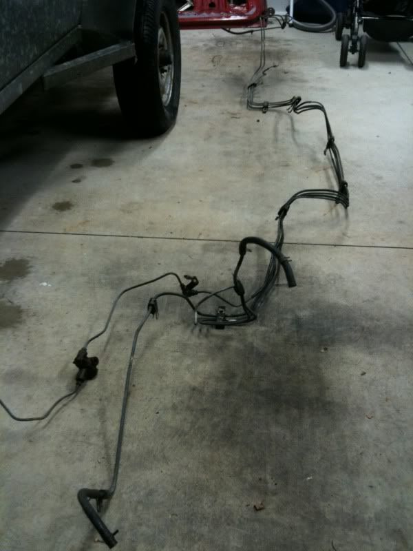

AE86 v's AE85 Fuel lines, how do i tell the difference ?
Postby beeker » Sat Aug 07, 2010 12:13 pm
ie, whats the size differences so that i can measure such.
I have one for sale soon, and want to make sure i'm advertising it as the correct product!

Those are AE85 lines, but just to confirm, the supply line from an AE86 is 8mm outside diameter. AE85 lines use hose clips/clamps the AE86 supply line uses screw fittings.
Postby beeker » Sat Aug 07, 2010 2:45 pm
Rick wrote:Those are AE85 lines, but just to confirm, the supply line from an AE86 is 8mm outside diameter. AE85 lines use hose clips/clamps the AE86 supply line uses screw fittings.
cool, its like 6.x something, so it must be a AE85 setup.
Assume its pretty worthless then ?

Also AE85 have a hose clip type fitting onto the mechanical fuelk pump as there in nor pressure there,
AE86 have threaded fitting onto the tank and filter as it is high pressure.
AE85 ones I would say are worth nothing.
I threw mine out.
