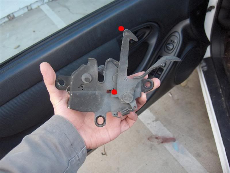

Postby 5OBAIT » Tue Aug 24, 2010 8:37 pm
Ok after playing around with the latch & getting no success it suddenly dawned on me what the problem is!!!! The latch on the 205 is different then the 202. As shown in the bonnet pics below....
Vented 205....
Standard 202...
The grove that the safety latch fits into is a lot bigger on the 202 bonnet which is why its not opening correct as the 205 must have a longer hook to compensate for the raise in the middle of the bumper.
So if anyone knows of or is wreaking a gt4 & has a bonnet latch please let me know.

Postby ®usty » Tue Aug 24, 2010 8:46 pm
yup :D
st205 = 3.75"
st202 = 2.75"
53510-20490 should be the part number
