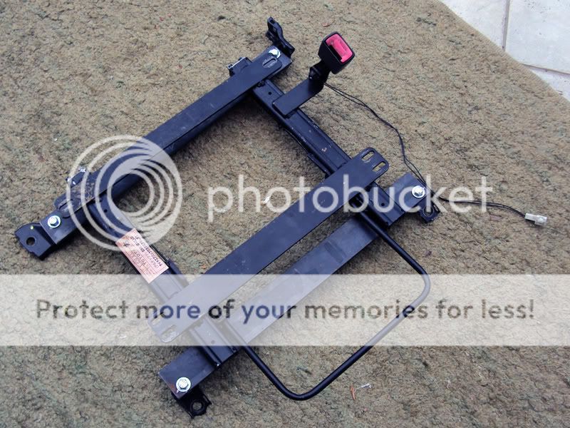

Postby RobertC » Wed Aug 25, 2010 10:12 pm
Have a look at the mounting points.
The picture below shows the mountings off a ae101 or ae111 levin/trueno drivers seat. Maybe check where your seats mount to see if there the same. If they look similar I can give you some measurements to confirm.

Postby Jooce » Wed Aug 25, 2010 10:15 pm
RobertC wrote:Have a look at the mounting points.
thanks mate i will check after work on friday and let you know..
