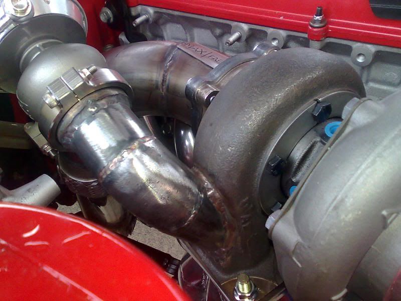

Postby evil_si » Mon Aug 30, 2010 6:39 pm
ive done that a few times, all depends on the exhaust housing
here is a pic of matt's one

Postby ATAl » Mon Aug 30, 2010 6:55 pm
sorry, meant boost creep not wastegate creep.
Evil_si, that's exactly what i'm after, the turbine housing is a .64 a/r off a garrett gt2860rs, do you think you could modify it?
