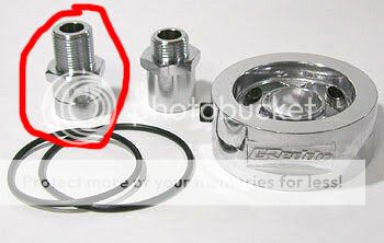

Postby RobertC » Tue Sep 07, 2010 11:58 pm
So I have a small problem I'm hoping someone can help with. I purchased some Greddy SMI gauges. Oil pressure and temp. Which came with the sandwich plate the same as the image below.
The piece circled in red does not fit though as its a different thread (was off a Nissan)
I have a Toyota Levin so I think the one I need is "Center bolt Pitch M24 X P1.5"
Is this correct?
And any idea where I could find one?

Postby Burning Angel » Wed Sep 08, 2010 6:56 am
the oil filter for a 4age or 3sge or pretty much any petrol toyota has a 3/4"-16 unf thread. m24x1.5 sounds like the one for a 2lt or 1kzte

Postby touge_ae101 » Wed Sep 08, 2010 9:15 am
i think i have one here sitting on my desk. not greddy but pretty sure what you are after. can chuck it your way if you PM me
EDIT: just checked it and its a bit different sorry rob. (took me a while to sift through all the crap on my desk)

Postby Bazda » Wed Sep 08, 2010 9:17 am
You can get one from Toyota.
Postby RobertC » Wed Sep 08, 2010 2:35 pm
Thanks for the info guys. Went to and had a chat with a mate a toyota he had a look for about 20 min but no joy. So went to hydra-link and the guy there thinks he can get one so I'm just waiting for him to phone me back.
Also found RHD sells them but, there $50 inc post (for just the bolt)
