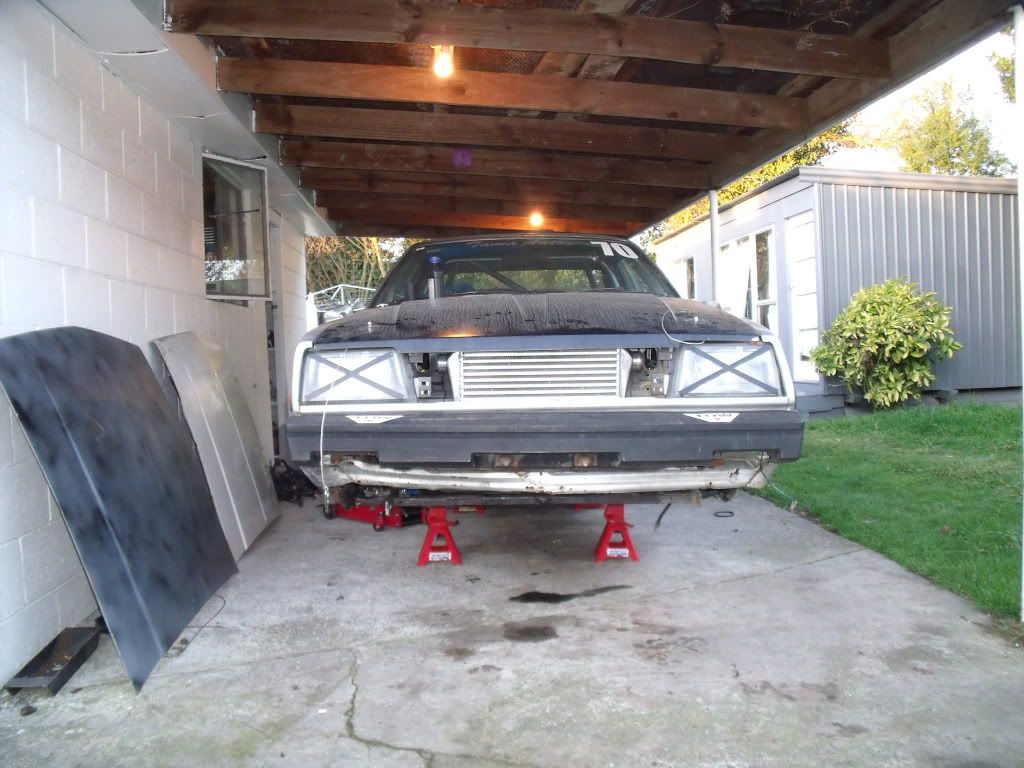

Postby d1 mule » Wed Sep 15, 2010 12:49 am
the oil cooler is mounted right up front but the monster of a '80s bumper is right in the way
the cooler is directly behind the bumper in this pic
hopefully i can whip up some sort of ducting before saturday which will hopefully help airflow to the radiator. the fans are thermostacically controlled if that makes a difference
