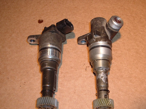

Postby iOnic » Sun Sep 19, 2010 5:18 pm
Pull the sender out of the gearbox and check if the teeth are very worn/chipped.

Postby iOnic » Mon Sep 20, 2010 11:52 am
Looks like so (one or the other)
