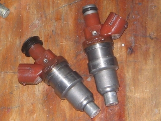

Postby touge_ae101 » Tue Sep 21, 2010 11:44 pm
what are they in terms of??? i will assume you know what they do in terms of injecting fuel into the engine.
this is what they look like
obviously there are slight differences between each type of 4age - BT, ST, 16V and ze but i think you can find that info for yourself if you look.
if it is a road car it is not worth upgrading them as unless you have done a serious amount of modifying they won't be the thing that is holding your setup back from making more power. 4age injectors are quite big for their application.
to give you an idea of what kind of modifications you can get out of stock 4age injectors, read up on BZR4AGE's build thread. fully rebuilt engine with toda pistons etc, nasty amounts of compression, 304 cams and pushing out a healthy 135ish kws and not in need of upgraded injectors.
this is my take on the whole 4age injector topic. anyone else please feel free to add more/tell me if i'm wrong.
