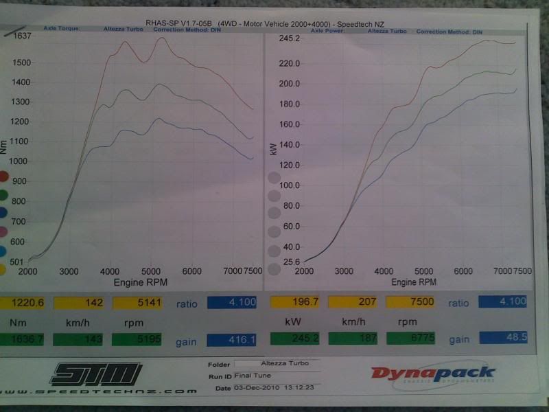

Postby Distrb » Thu Aug 04, 2011 3:09 pm
i managed to get >this< from a GT2871R at 16psi boost strapped to the side of a virtually stock 3S (alebeit in an altezza). Is a fairly good example of what many consider a smaller framed turbo will do but still not at full boost till 3700rpm. Ultimately it is a responsive and very streetable setup and is pushing the limits of that turbo at that figure.
TBH i dont think you are going to get a turbo to bring both the response and the top power figure you are wanting
