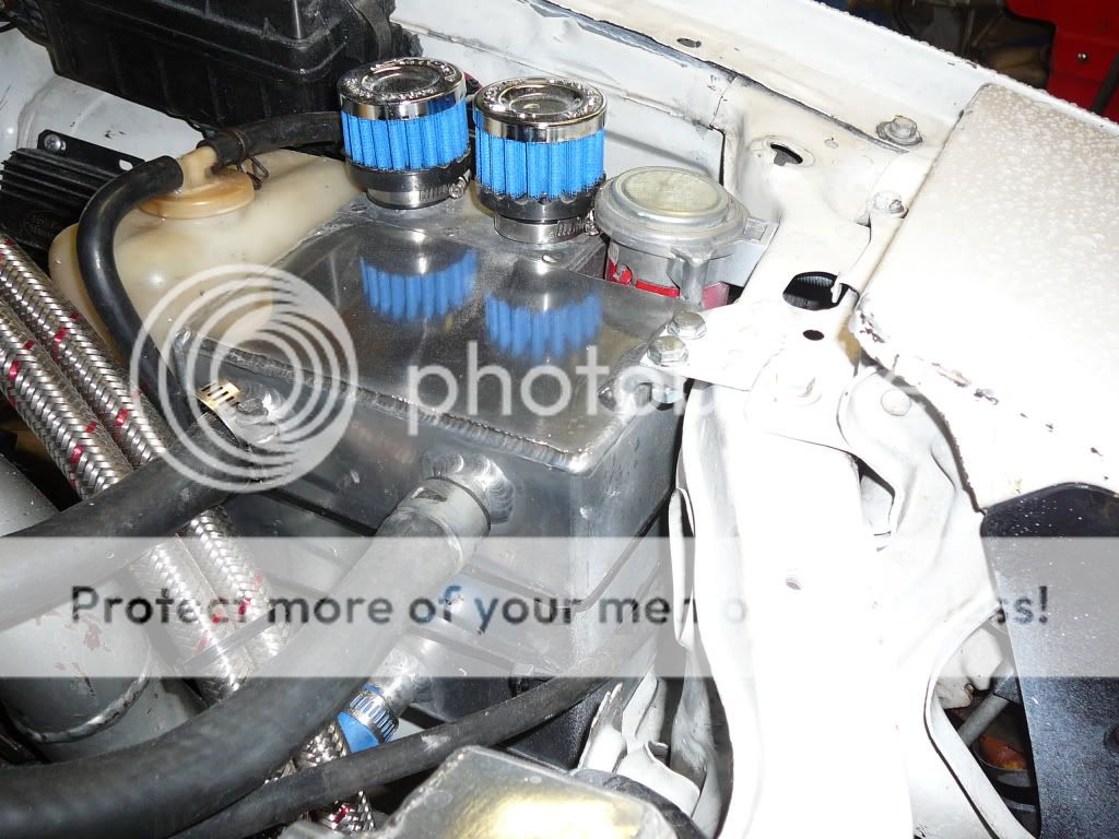

So I designed what I thought would be a solution, pretty much a bigger version of Toyota's external oil drain. Basically its a 2L catch can with twin air filters and a 5/8"drain from the bottom of the new catch can straight the sump. I even had raised box sections added to the top of cam covers for the new large breathers going to the catch can.
Here they are with the catch can:
Fast forward to today, I went to Manfeild to do some testing. I drove it hard for about 20minutes and it was going very well. Oil pressure looked good, water temp was fine (previously it had overheating issues after 5 laps). I was happy and gave a few people/cars a surprise! :lol:
BUT I pulled into the pits after a cool down lap and what do you know. A big oily mess, not a small amount either I'm talking lucky-there-were-no-dead-bearings amounts.
After a bit of discussion in the pits, it was decided to test blocking off one of the breather hoses (from factory there is only one anyway). Theory was that there were two from the cam covers but only one, of the same size draining to the sump. So I tried it, did 4 or 5 laps and its was a $&#$% mess again.

Postby QikStarlie » Mon Jan 23, 2012 10:39 pm
up the diameter of breathers to start with. this is the only thing i did to mine and it made a big diffrence, single 1" pipe. thru baffled (keeping flow no less than 1") catch can and 1" exit, vented to atmo, no filter, they clog. bigger the breather less velocity to throw oil out.
run another drain in the back of the head lower down,
also those small filters wont be helping, soon as they get oil in them will be like a cork, so crank case pressure will rise. may find since you return is lower than the oil level crank case pressure is pushing oil back up the drain.
short version i would put fitting in the back of the head low down and plumb it straight into your sump. above oil level. plus add big free flow catch can setup.
edit: have you tried running it without the breather filters?

Cheers for the suggestions:
Each cam cover breather is 5/8" I/D hose so a total of 32mm of breathing capacity from the head (not including factory oil drain). This was a massive difference from the tiny factory single breather.
The air filters might look small but they are both 25mm outlets so a total of 50mm or 2" of breathing capacity from the catch can.
I think the oil draining to below the oil level (pretty sure, will have to measure) is definitely contributing. I'll look at move it up as high as possible.
Good idea with the secondary oil drains, do you mean the lowest point of the cam covers or tap into the head itself? I could easily add some big outlets below the current big breathers (about 5cm lower), and maybe have it drain to the sump but at the back/firewall side to get it out of the way.

Postby DexGT » Tue Jan 24, 2012 7:13 pm
I had a similar problem in the starlet , it would fill a 1 ltr catch bottle in not many runs at the track . I decided to build a better system and it ended up like this
I drilled all the fittings on the head to be the same size as the hose , inside the box it goes thru foam and any oil drains to the low point where it can go to the sump.
The thing I think actually does the most is in the cam cover , I removed the plate that's fitted factory for separating the oil ( which it doesn't) and used an idea I got from the problems RB26's seem to have (people remove the gauze stacks that are fitted factory, then get oil problems) I fitted a stack of gauze under each breather pipe and a goldilocks pad around the stack.
I have now done 2 manfield dual car sprint days and the catch box is barely damp inside.

Postby matt dunn » Tue Jan 24, 2012 7:15 pm
~SlideWays~ wrote:Out of interest in your race car, have you always run a 20v head? If not, did you ever have head oil surge problems? Obviously north south on yours vs east west on mine, but I also had the supercharged smallport in an AE86 and that also had similar problems.
It is a common thing with all 4age's, My 20V had the same problems.
I have it sorted now though.
You need to run a rerurn line into the sump,
must be above the oil line and not in a place where the crank pushed pressure up the hose, have tried a couple of places in the sump, the first did not work the second one did.
Also need to run a baffeled catch can with a reasonably large volume,
not just to hold the oil, but the large volume has a slower air speed through it so the oil drops out of the air,
I also changed from 2 15mm pipes to a single 40 mm one, welded into the tappet cover,
and I also run the oil level about 2 or 3 mm down from the full mark on the dipstick. If you fill it further it will just blow it all out back to this level.
That's all on my car anyway.
Last season it ran the 2 small breathers and no return to the sump,
and over a rtace weekend I would drain about 3 litres or more from the catch can, but it did turno out to have a mechanical issue too at that stage.
