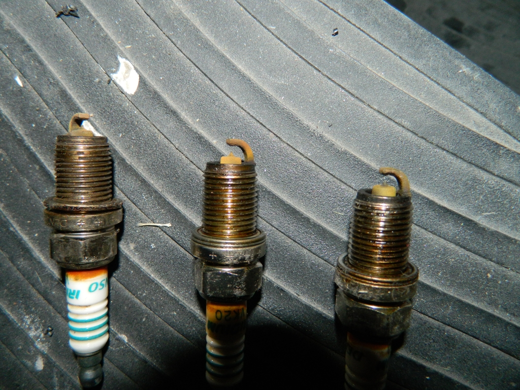

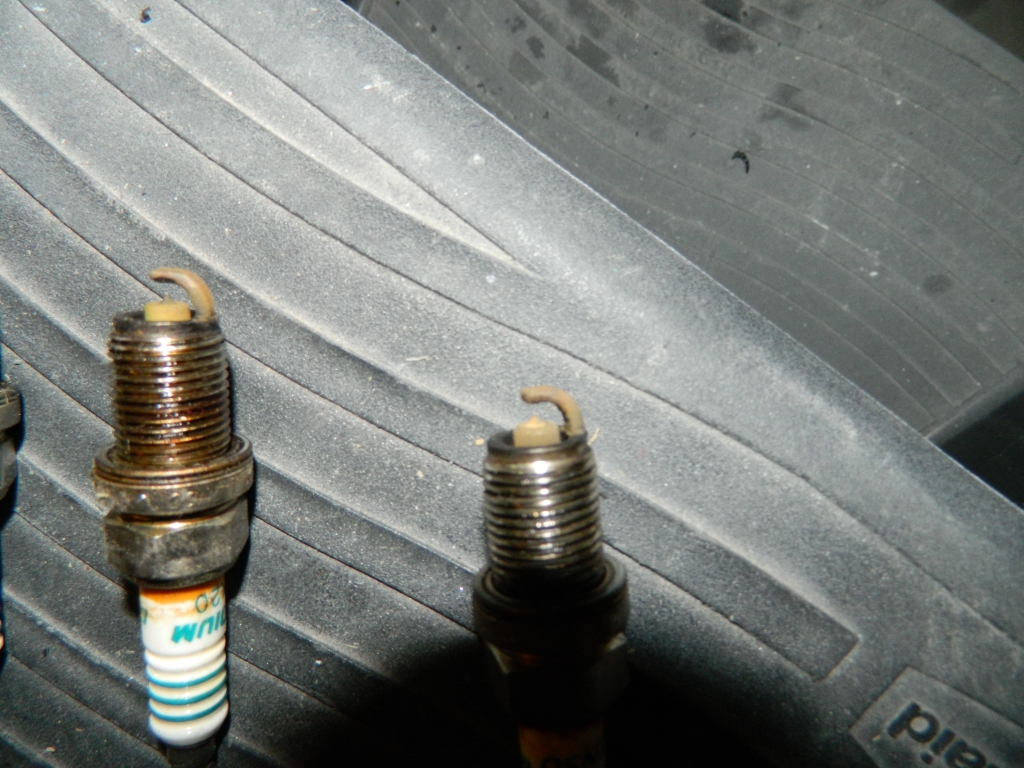

Postby UtahSleeper » Sun Oct 25, 2015 3:52 pm
And here is what the plugs looked like when I replaced them. The car was running rich and it failed the emissions test with these. Haven't retested the car cause I can still smell the exhaust.

Postby RS13 » Sun Oct 25, 2015 6:06 pm
You replaced those plugs? Those plugs in the pic are as old as the hills, note the staining on the porcelain which indicates compression leakage.. they've seen better days.
I've fixed half a dozen badly-running 3S engines now by simply replacing the CTS.. they're a known weak spot in the 3S engines. The last (Caldina) was running so rich it was a pig to start and wouldn't idle, swapped in a new CTS (they're around $30 in NZ) and problem gone. Always the first thing I replace now.

Postby UtahSleeper » Sun Oct 25, 2015 7:14 pm
RS13 wrote:You replaced those plugs? Those plugs in the pic are as old as the hills, note the staining on the porcelain which indicates compression leakage.. they've seen better days.
K, I will replace it. Just was more curious as to what to take from the ECU seeing a proper temperature. Or is there more going on in a temp sensor then just the signal being sent for temp?

I disconnected the fan for future testing as I am just idling. This has allowed the motor to get to "proper" operating temperatures.
