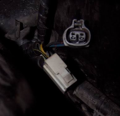

Postby Rick » Tue Aug 08, 2006 8:43 pm
Santa'sBoostinSleigh wrote:and for some odd reason the engine fan always goes when the key is on :S
That would be because you have removed air conditioning, there is a pressure switch on one of the ac lines, with it not plugged in makes the fan/s go. either plug the switch back in, or bridge the plug.
Postby Santa'sBoostinSleigh » Tue Aug 08, 2006 9:06 pm
any idea which plug?
im guessing its bridging the two prong plug?

Postby Rick » Tue Aug 08, 2006 10:04 pm
Iam 98% sure its the one marked in the photo below (which is pluged into the ac lines), I will have to have another look in the day light to confirm. Do you still have the a/c sensors, switches etc.. if so you could try and plug them back into the empty sockets
Postby Santa'sBoostinSleigh » Tue Aug 08, 2006 11:57 pm
its alive!!!!
....kinda
still needs work but she runs
ecu wasnt powered up correctly, its hotwired now
got the fuel working ok
no rev counter
no idiot light
this is the damn rangiest car ive ever owned....
i plugged a socket thingee into the 2prong plug, now the fan doesnt go all the time :) (havent checked to see if it goes when hot yet)
