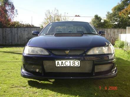

Not to sure about the compatibility of the AE101 bonnets.. But just beaware that the Trueno and Levin bonnets are different.. And the scoops on the gtz's are in the centre of the bonnet i.e. over the cam covers, not over the intake
If you really must its prob better to get the rex scoop mounted right on top of the trumpets..
like this guy on his AE111..

And don't forget other thing: the trumpets are a bit off to the right of the car so #1 and #2 will not be under the scoop anyway. If I were you I would make an airbox around it and say 4" hose feeding it from the guard.
Postby Calvin » Tue May 29, 2007 3:22 pm
sergei wrote:And don't forget other thing: the trumpets are a bit off to the right of the car so #1 and #2 will not be under the scoop anyway. If I were you I would make an airbox around it and say 4" hose feeding it from the guard.
i second that

Postby rolla_fxgt » Tue May 29, 2007 10:04 pm
what about having the wrx scoop, but having a box round the trumpets thats open on the top & buts up nicely to the underside of the bonnet, using some sort of rubber glued to the top edge of the box making a nice seal.
Means the scoop is centered so doesnt look like a blindman's done it & you get the benift of copious amounts of fresh cool air. But just be careful you dont make it so it sucks water down the trumpets.
