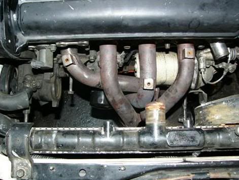

Anyone tried a blacktop 20v to an early C52 from an FXGT with the single starter bump casting on the exhaust side, its just the C52 has a TRD LSD fitted I would like to use without having to go to the expense of another LSD in the blacktop gearbox.
Maxwedge
Posts: 88
Joined: Thu Apr 27, 2006 10:02 am
Postby Distrb » Thu Jul 26, 2007 2:58 pm
Yes
Had to modify the 20v headers (number 1 runner actually) slightly to allow the starter motor to sit in there.
i also ended up cooking the stater motor over the period of about 3 months because of the heat.
Some dont have to mod the headers, and never had problems with the heat affecting the startermotor.
you can use the LSD diff you have in a 'blacktop box' as it is the same

i had a c52 with an older starter and just removed some of the heat sheilding and stuff and it fitted fine

the reason why your starter cooked itself was because you heat wrapped the wrong thing, your ment to wrap the headers not the starter, keep the heat inside the exhaust not starter,

frost wrote:the reason why your starter cooked itself was because you heat wrapped the wrong thing, your ment to wrap the headers not the starter, keep the heat inside the exhaust not starter,
Not sure i agree with that, as even with the headers wrapped, they still died
Distrb
Regular Poster
Posts: 4756
Postby frost » Thu Jul 26, 2007 9:15 pm
oh ok, may just be the pick of the bunch, also the heat wrap will keep moisture inside too,
Postby Distrb » Thu Jul 26, 2007 10:50 pm
yeah, perhaps the starter motors i had were on their last legs. Not sure if anyone else has ever had an issue like that in this config
