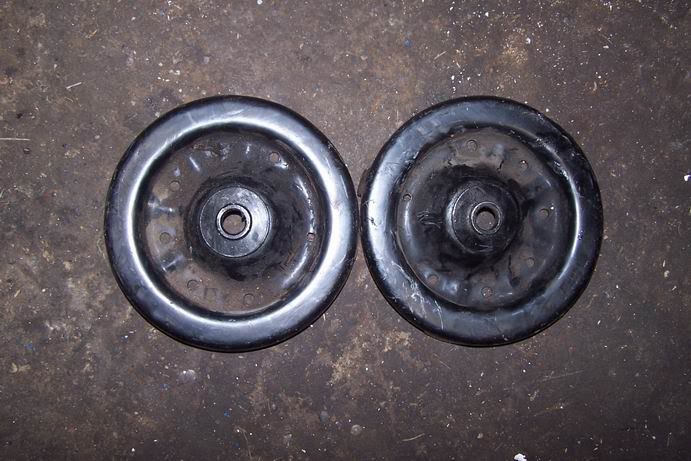

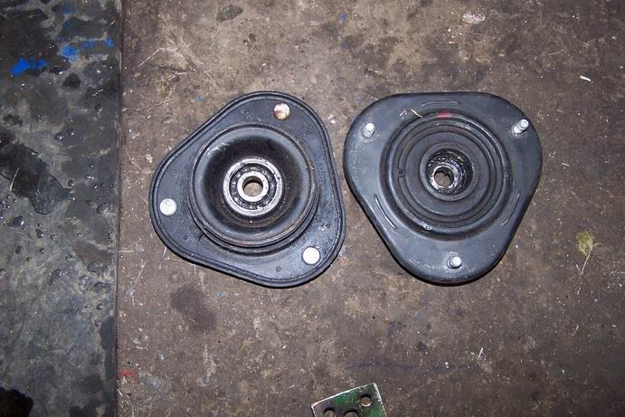

Did you guys mean fit the stock struts or just fir the stock tophats?
IS this what im after? which one or both?
http://i22.photobucket.com/albums/b346/ ... 0_2870.jpg
http://i22.photobucket.com/albums/b346/ ... 0_2869.jpg
TRD_ZERO
Posts: 1077
Location: Howick
Postby rwd_mayhem » Thu Aug 02, 2007 7:21 pm
1st pic is what the original spring seats into, the 2nd pic is the top hat, which is what you will need to change for wof.

Postby TRD_ZERO » Thu Aug 02, 2007 7:39 pm
Oh ok so i just need those those triangular shape ones? Fitting them? Would i have to take them to a suspension shop to get it put on?
TRD_ZERO
Posts: 1077
Location: Howick
Postby rwd_mayhem » Thu Aug 02, 2007 8:34 pm
yea the triangular ones, nah its a pretty simple job, just need some spring compressors.
