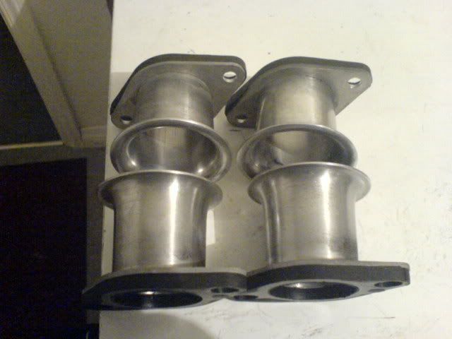

iv come across that in many many places asweel.
which means those ones n the KP above are not the best....
wasnt there another thread on here recently with info on the radius needed etc?

Postby gasman » Wed Aug 01, 2007 8:25 pm
47mm wide at throttle body side and length is about 50mm i think

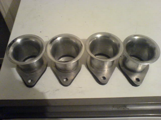

Postby QikStarlie » Wed Aug 01, 2007 10:54 pm
simple test, sick a bellmouth on the end of a vacuume cleaner. see where the air comes from.
interesting post here, look at the images about half way down, about flow into tubes:
http://forums.fastfours.com.au/viewtopi ... ake+tuning
if the air does come from behind. it isnt going to be of much use to you. unless you have a proper full round edged bellmouths,like in frost's post.
so your average bellmouth, should be better with a flat plate behind them. if thats the case
the kp's setup is all about helmholtz, the downfalls it has are outweighed.
