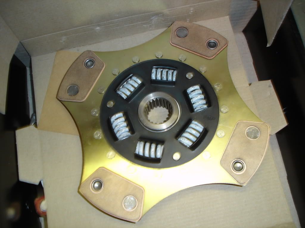

I think i may have blowen up the clutch. I dropped it in second gear to pull a line lock and the wheels didnt spin but the revs went up :lol:
For you omg no street racing, this was at my mates horse farm out near waiuku. We were just playing around. It usually linelocks in second fine. I've had it slip in thrid accidentally before and the clutch was fine after.
Clutch in at the moment is a RPM 4 puck clutch. Not sure on material but it looked ceramic.
Now it just wont hold at all. I can pretty much stop in first gear and the engine will idle with the gears engaged. Its like it suddenly disappeared.
I concluded that it either went pop and exploded or i fully glazed the ceramic real good. Thing is i never smelt burning clutch. Although im not sure if a puck clutch smells like organics do.
Once a puck clutch is $&#$% its $&#$% right? It wont slowly come to like organic ones?
Anyone recommend a clutch for my car? Uses same clutches as toyota levin GZE's.
Here is a pic of the clutch BEFORE i put it in.
Dont want to know what it looks like now :X

i got a three puck and it lights up 2nd easy as sounds like you need to take it out man.
If you do can you post a pic id be keen to findout what it looks like.

you can get them re-lined man, just un-rivit the ceramic bits and replace. will be way cheaper than a whole new kit, but depends if the cover is $&#$% also

take it back 2 whr u got it from same clutch as mine been easy couple thousand ks and when i slap 2nd hard feels like dash is ripping apart done a couple 3rd gear skids to, looks a little differnt to mine i got the stage 3

sounds like you glazed it or incinerated the lining.
as escortman said, a puk clutch should feel like its gonna rip the car in half depending on how you let it out :lol:
most clutch speciallists can reline them. i know of one place in wgtn where i got mine from but you're a bit far away i guess. they put together a custom kit for my car and modifed the pressure plate for extra bite etc.

Found something strange, when i went to remove the slave cylinder the little bit that pushes the clutch fork was still quite tight. I unbolted the slave and it looked as if it may have moved the fork forwards 1mm. Was hard to tell but heard the fingers in the clutch moving.
Im sure it wasn't like this when i installed the clutch because i would have had no way of fitting the slave! maybe there was a air bubble that finally found its way out or something :? :? :?
Dont think it could have made such a big difference though, and i did bleed it!

In my experience they most certainly don't. With Ceramic I've always ended up coating the ceramic in flywheel and glasing both metal surfaces (IE that of the flywheel on the ceramic and the flywheel itself) A Ceramic should grab harder with slip, unless its damaged.

Well for some weird reason its working again.
Removed the slave and fitted a shorter rod, the clutch wouldn't disengage anymore so i put the old one and and the clutch still wouldnt disengage!
Just before it seemed like the clutch wasn't engaging fully.. now thats weird.
Its the same setting ive been running since i put the clutch in and it worked fine.
So i bled the clutch a lot. Still the same.
Then i adjusted the clutch up at the master cylinder, to give the clutch more throw, now it would finally disengage. Still no clue why this all happened. Maybe a rogue air bubble...
Went for a drive and it was sweet, it makes a slightly different noise, i suspect it is damaged. But it is a 4agze 4puc clutch with a heavy pressure plate only seeing 130odd KW and shit all torque.. so its under $&#$% all load. Im happy it doesn't slip.
