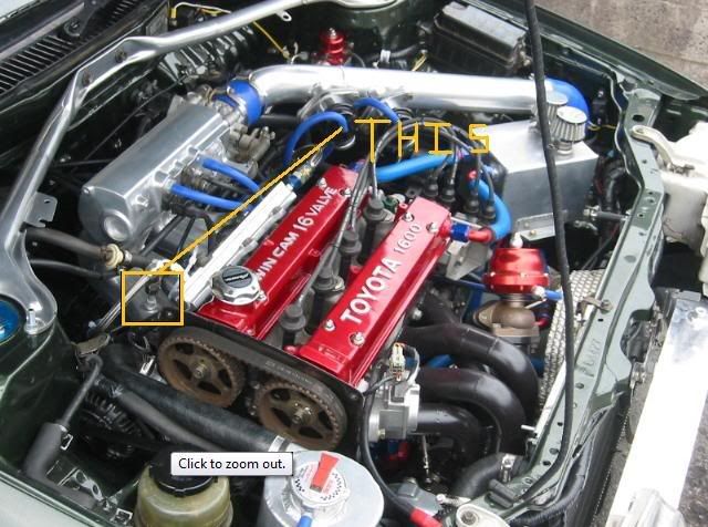

right, went out to get some rubber hose. and as soon as i pulled in the driveway, i lost all vacuum assistance.
looked at everything (so i thought), the one-way vavle was working fine, didn't lose any fluid, the booster wasn't leaking and the master cyl wasn't seized. the hoses were clear.
out of chance i had the light on and took a glimps down the pipe fitting that screws into the intake manifold for the booster line to go on. it looked blocked, so i took the fitting out.
in there i found about 15 small porcelain or ceramic type balls in that fitting, they were big enough to not go through into the intake manifold, but yet i have no idea where they came from :? basically they were big enough to block the hole off so no vaccuum could get to them.
i've searched about brake boosters and they dont seem to have anything ceramic or porcelain in them, jsut a big diaphram, and not they'd be from the one way valve as it's too small to fit them all.
noones been able to get near it to do something like that, and they weren't there when i installed everything.
so anyone got any ideas as to where they came from? i've asked a few people and they have no idea,
in the fitting shown in this pic
any suggestions are welcome,
brendon

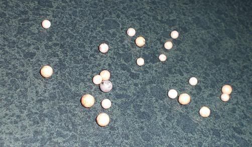

Postby IH8TEC » Wed Apr 30, 2008 3:18 pm
ok, so went and found most of them, found 21, probably more scattered over the floor.
what you all think?

so they are hard? could be insect eggs. from when your parts were just lying around pre-assemble?

I have seen inside tyres, when taken off the rim - little balls of a similar size as the result of dust/powder inside the tyre getting mixed up with some moisture and rolling up into balls.
Ceramic... random!

Postby IH8TEC » Thu May 01, 2008 12:39 am
haha, i'm assuming it's a ceramic or porcilian as they are really hard and have a bit of a shine to them in person. i think i'm gonna put them in a bag and put them on my shelf.
Postby matt dunn » Thu May 01, 2008 1:07 am
IH8TEC wrote:haha, i'm assuming it's a ceramic or porcilian as they are really hard and have a bit of a shine to them in person. i think i'm gonna put them in a bag and put them on my shelf.
crush one and see what's inside?

Postby Crucible » Fri May 02, 2008 12:53 pm
are they soft?.
Ive seen brakefluid that has been sitting for ages in a mast cyl turn into a powder, sorta like battery terminal corrosion. Maybe thats whats happened and its worked itself into balls?? mast cyl bypassing into the booster at some stage?

Postby IH8TEC » Fri May 02, 2008 1:09 pm
i tried cutting those balls open, too hard to cut lol, it just $&#$% off umm smashed it with a hammer and bits went flying in all directions, and the bit that took most of the impact, just went into a gritty dust, but still quite hard. and other bits that were broken off it were in hard chunks
i'm going to take the rest to auckland to try find out what they are. i will get to the bottom of it :twisted:
Postby Voyeur » Fri May 02, 2008 1:15 pm
What's the average size?
did you have any of your parts medium blasted?

Postby IH8TEC » Fri May 02, 2008 1:26 pm
they blast the manifold before pro-coating. however i'm 100% positive they weren't there when i installed it after cleaning the thing out.
and its not like ali oxide that we use at work for blasting alloy, i suspected from bead blasting. but again, not there when i put the thing on.
this is whats got me puzzled :?
