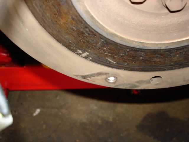

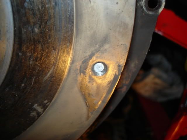

So i was all set for big day in the garage, ws getting into and bolting up my new clutch cover to the flywheel, was torqing it up, reached 15ft.lbs then i gave a little push for luck and snap. wicked!
the pics show the results.
CRAP!
There it is
How the f*** do i get that out?

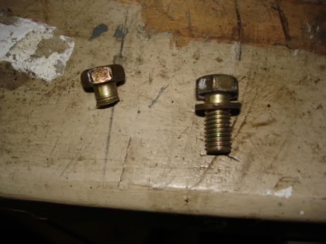

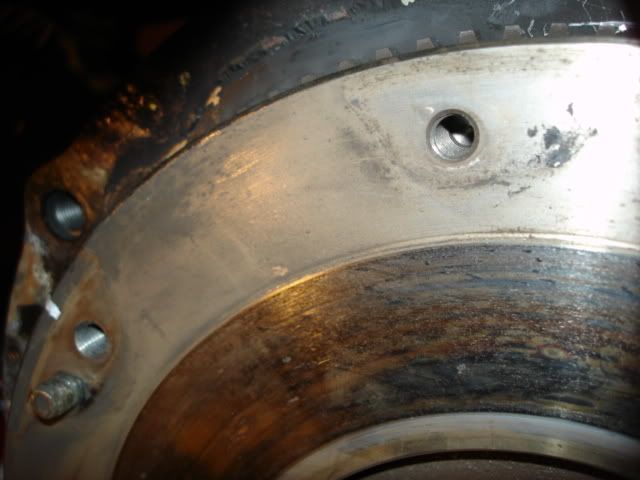

But it should look like this
So toyspeed gurus I'm guessing im not the first to snap off a bolt so how should i go about getting it out?

Use an 'ezy-out'.
You drill a small hole in the center of the bolt and screw the ezyout into it and turn it until you get the bolt out.
Its like a tapered reverse thread bolt for removing broken off bolts/studs

First try to turn it out with a scriber, the threads are not loaded now so often you can.
From memory it is M8.

Has happened to me but i managed to get it out with a small flathead. Managed to get enough grip to turn it.

i done the exact same thing a while back, thought they were the high tensile bolts but they weren't. had to use a screw driver to work it out, seeing as there was no pressure/tension on it it came out relatively easily.
might pay to check the rest of your bolts too!

Should be easy to drill as they will be low tensile bolts. The dowel pins take the clutch torque, not the bolts so they are loaded in tension.
Get 6 new high tensile cap screws of the right length (they will be a standard size). Will cost all of $2. Any engineering supplier will have them.
