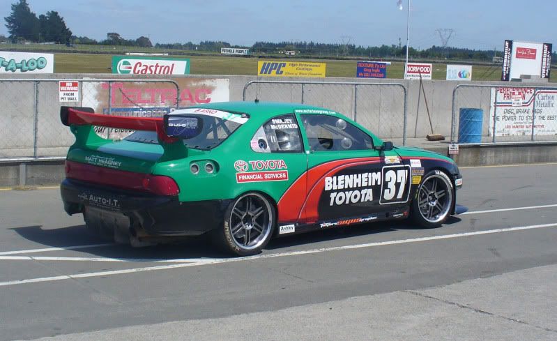

Yes we have converted two AE101 Corolla's to RWD now,
and also the 2005 Ford Focus with the XR6T.
We used the AE101's as when we built the first one they were quite a modern car and we wanted a car that was newish shape.
The Second was built as a copy of the first car, but more aimed towards endurance races.
It actually finished 2nd last weekend at the NZV8 event at Ruapuna in the 3 Hour Endurance race,
against the Ferrari F430, ex V8 Supercar and the 10 or so GT3 porsche'e that entered.

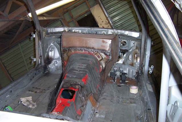

I have a few various ones,
This is the first car we built,
I ran it at the 4 & Rotary's in 2002?
This will give you an idea of how big the modification is

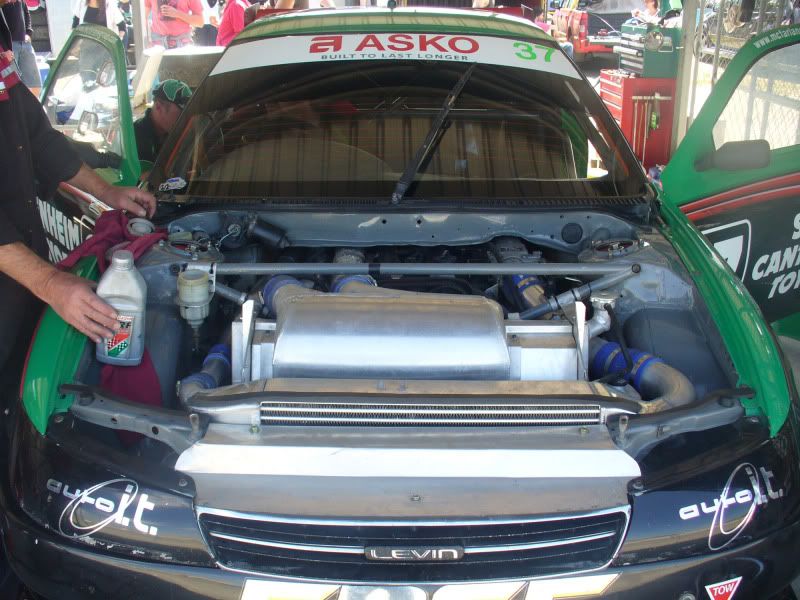

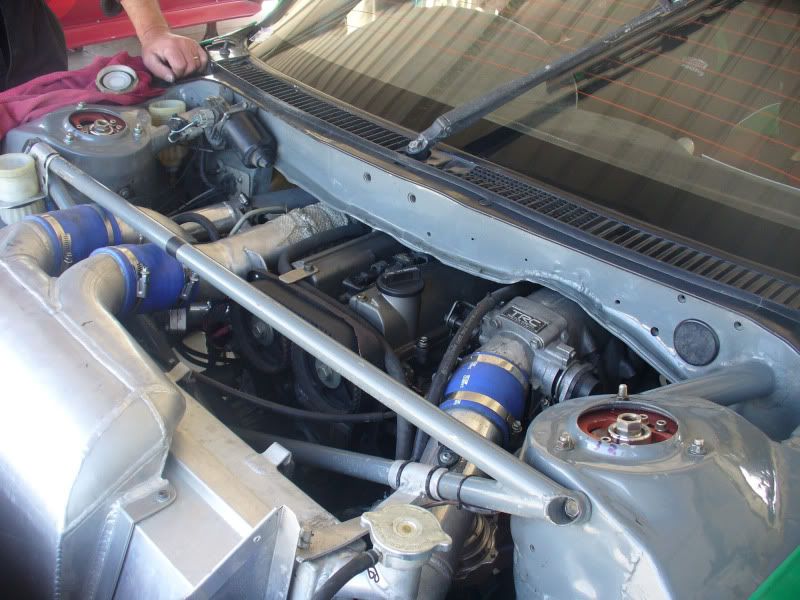

and here are some various ones of the second one we built the same.
http://i16.photobucket.com/albums/b20/M ... gine-1.jpg
http://i16.photobucket.com/albums/b20/M ... gine-2.jpg
http://i16.photobucket.com/albums/b20/M ... DAE101.jpg

What got sacrificed for the tunnel? :lol:

well those pics definitely put it into perspective haha
did the motor have to be mounted that far back or was it just for weight distribution etc?

Postby 1I1 » Fri Dec 10, 2010 9:47 am
Oh you were driving at the 4&rotary nationals! Here i was thinking it was driven by a banana
Can't imagine it would be easy to work on! Pretty much engine out to do anything on it?

Postby matt dunn » Fri Dec 10, 2010 5:57 pm
h8wrxs wrote:well those pics definitely put it into perspective haha
The rules stated that you were allowed to move number 1 cylinder spark plug back by 5% of the wheelbase,
so that is where it is.
It ended up with almost exact 50/50 weight distribution.

Postby matt dunn » Sat Dec 11, 2010 12:00 am
d1 mule wrote:^ 5% back from where??
from it's factoy location.
they never anticipated turning the engine around 90 deg,
so there was a bit of debate at the time,
but it was within the rules.
