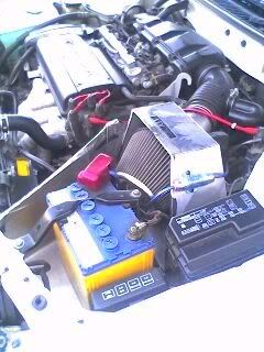

Postby bad20v » Thu Feb 16, 2006 6:41 pm
The only one I have at the moment is this:
You can see my extractors have been wrapped, but its not a very clear photo as it was taken from a camera phone. :?
