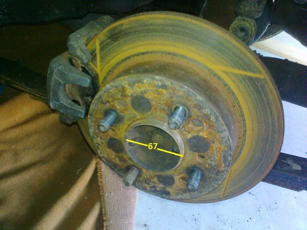

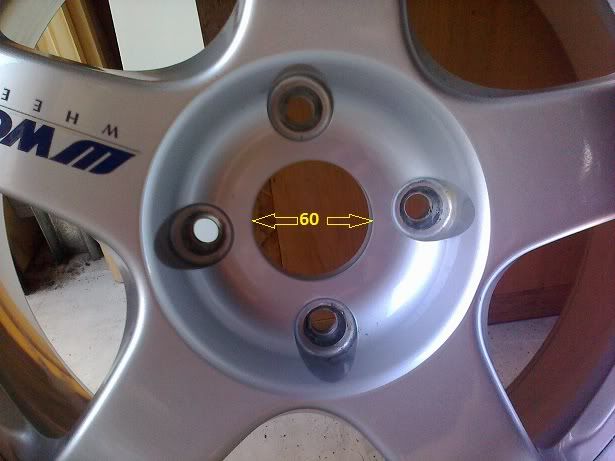

iv just bought some new wheels for my car, only issue is the centre locator bore on the rear wheels is smaller than the locator on the hub.
what i want to know is can i bore out the centre locator bore on the wheel to suit the locator on the hub...or is there a way i can get a smaller locator? i presume i cant machine down the locator it self so thats out of the question, let me know what you think guys, iv attached a couple pics

Toyota has 60.1mm hubcentric ring. Strange to find the wheels are to suit that, most of the time they're 67mm hubcentric to suit Nissan/Mitsi etc.
Is there a press in locator ring in the wheels? If so, pop it out and get the correct thickness one (or may not even need one). Otherwise, it would have to go on a lathe to be milled out and then re-balanced.
Maybe take a photo of the back of the wheel rather than the front, so we can see?

these are being bolted to a 1973 corolla, i got these off an rx2, what im saying is, is it the best option to machine the bore out, or do you think i should get a new locator ring? its a hilux rearend if that helps
il try get a picture of the back

yes if not bore it out , any engineer can do that for you , if you are in auckland i can get it done for you 8)

Find a local machinist to machine out the wheels, don't be a muppet and machine the hubcentric ring off the hubs. Get them machined to a common size and then you can get adaptor rings to use them on other cars.
