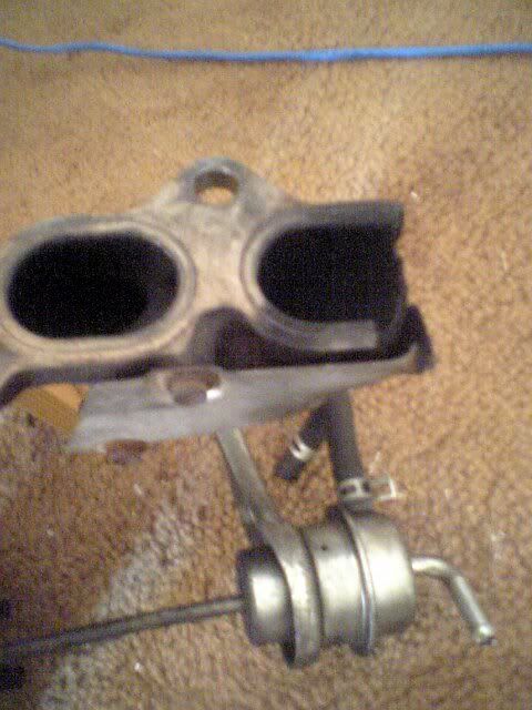

Postby Skin » Wed Feb 01, 2006 5:53 pm
yeah and then you get the more extreme thing happening....

Postby Mr Revhead » Wed Feb 01, 2006 5:56 pm
lol bloody hell, some one ignored the leak for a looooong time 8O
