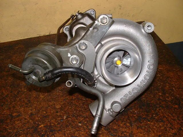

phothog wrote:Ah.. mmm we dont need the engine. just the turbo... if you do anything with us.. uummm dont send the engine.
maybe i should clear it up ...
$1480 inc GST is for a Rebuild & upgrade on a CT26 turbo.
for
1 x T04E 46Trim Compressor Wheel, 2 x Bearings
2 x Piston rings, 2 x Orings 1 x Turbine wheel & shaft assembly,
1 x Shaft nut + Machinng, Labour, Balance, including a spin on New Zealands only True VSR (Vibration Sorting Rig) balancer.
i have a picture here of one we have just done.
Phothog
