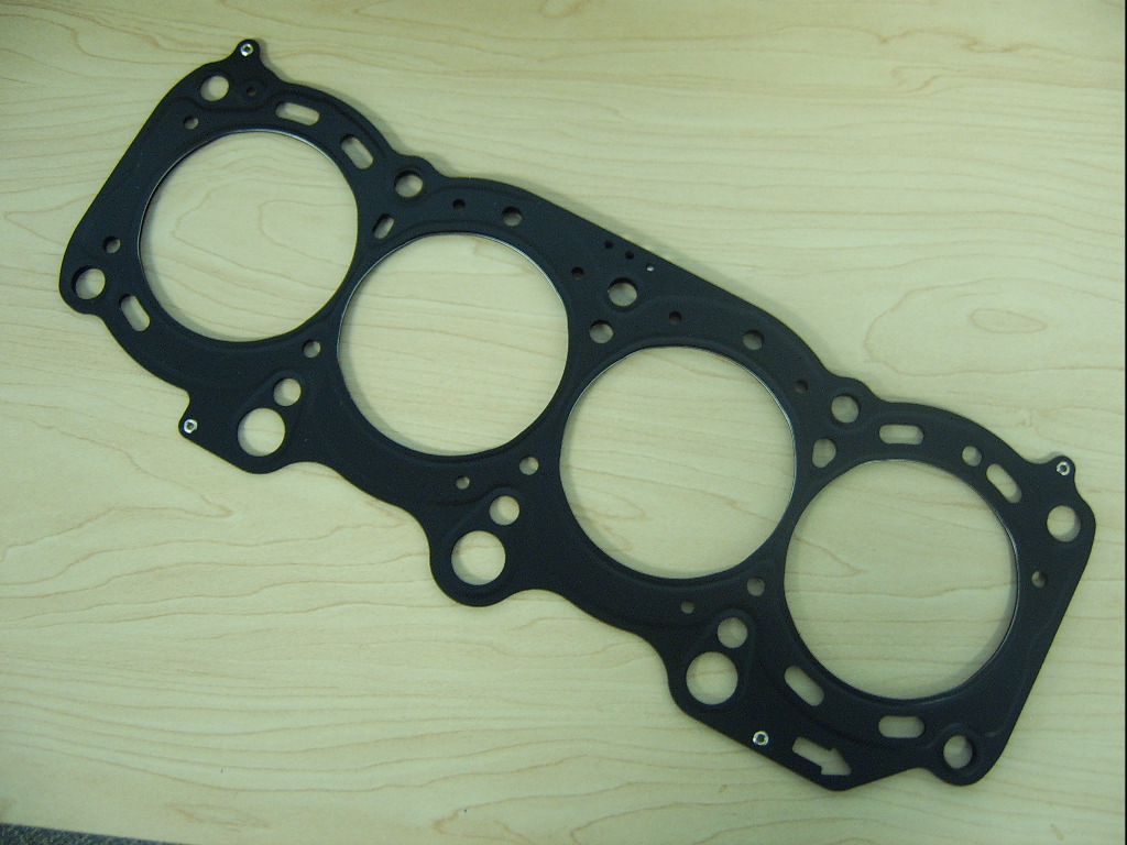

Multi-Layered Steel just like the TRD one ;)
http://www.kbox.ca/catalog/images/SV503379.JPG
Re: Head Gaskets
Postby matt dunn » Thu Sep 11, 2008 1:06 am
fivebob wrote:Multi-Layered Steel just like the TRD one ;)
Well I'd be looking for another type of gasket.
earlier or later model 3S one's that aren't multi layered steel?
Re: Head Gaskets
Postby fivebob » Thu Sep 11, 2008 1:13 am
The Gen III gasket was a vast improvement on the earlier composite ones, which were well known for blowing when the boost was turned up.
Unless there's something wrong with the way the head and block were resurfaced then the standard steel gasket should be more than capable of doing the job.Stock Gen III gaskets have been used on quite a few 500HP+ 3S-GTEs, so I don't think there are any inherent problems with them.
Yamaha have been using multi-layered steel gaskets for over 25 years and IME they are a lot less prone to failure than the composite variety, provided that they are installed properly.
