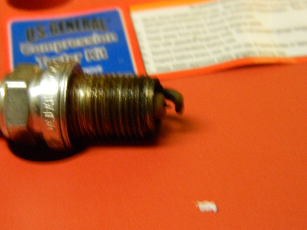

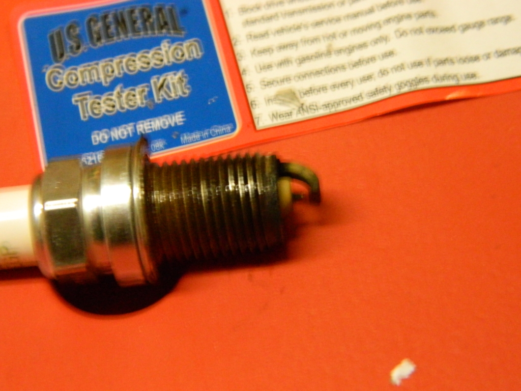

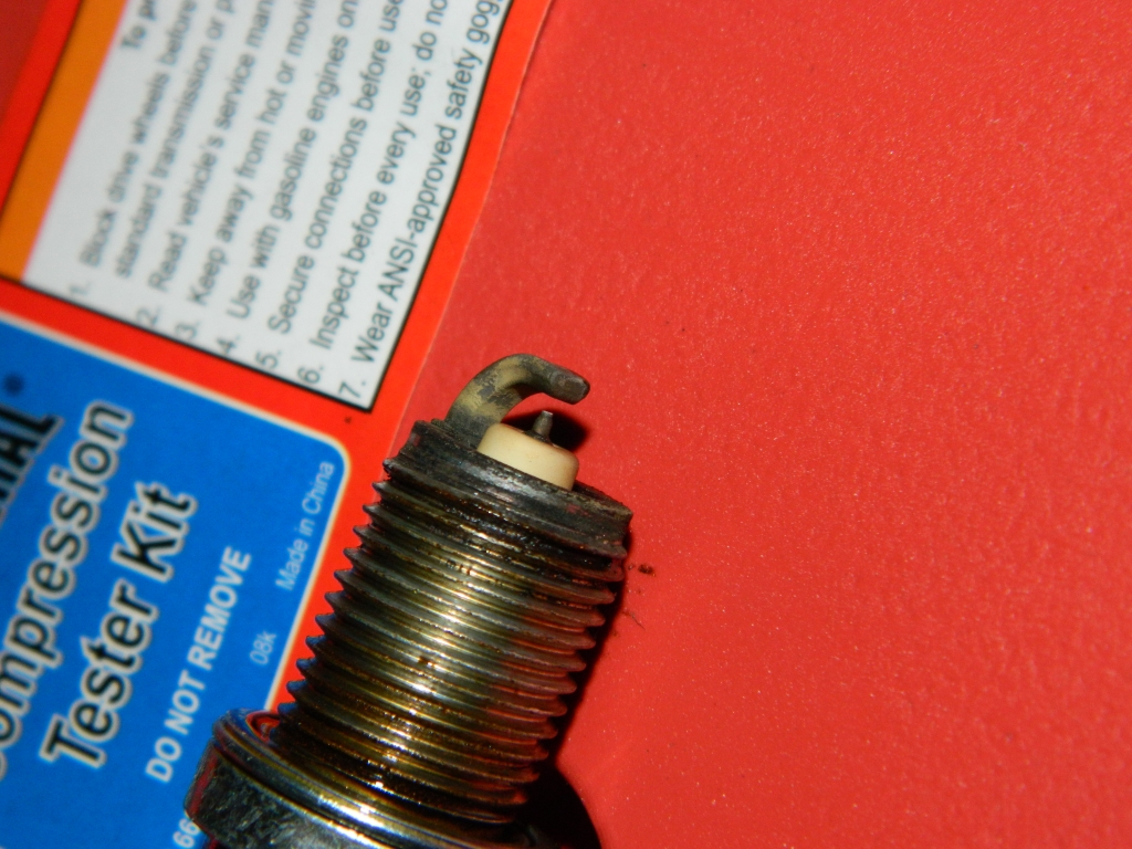

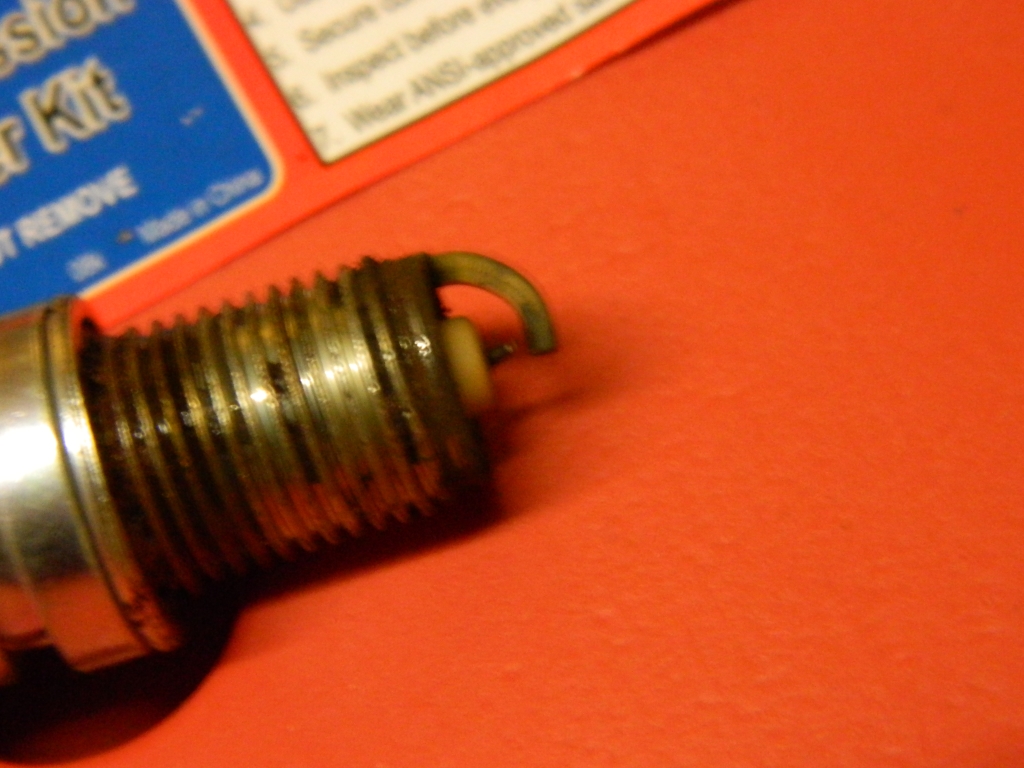

This is what the plugs look like after about 50 something miles. Sorry for some blurry pics, but they all looked about the same.

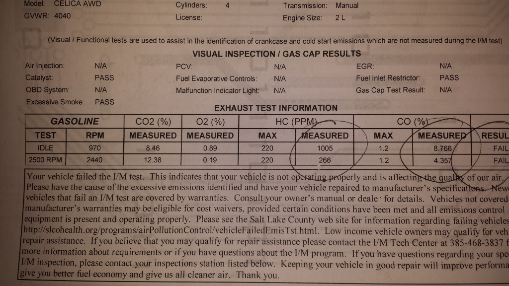

And here is my previous emissions readings. My last check had about the same results.
Also had my friend rerun an emissions test and the motor is still insanely rich. I averaged 10 mpg out of the last tank.
