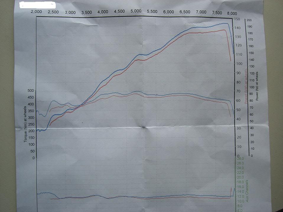

Pics of the dyno results -
speedfactor did a great job with the tune.
Red line is the PowerFC with the base Maps
Blue line is the tuned map.
Took 29 runs and about 1.5hrs on the dyno.
Running quite rich (for a NA car), they tried to lean it out but it just lost power.
The VVT-i settings on the base map were almost perfect, only thing they changed was 3 degrees intake for the last ~2000rpm (you can see the power jump).
Apart from that, the Base map is really good, just the fuelling is a little rich.
I didn't do a run with the standard computer in.
Compared with the standard computer, the midrange is alot better, now there isn't the torque hole from 3.5k to 5.0k rpm.
Much more pleasant to drive :)

be interesting to see what power it has on the dyno you used originally, for a more comparible figure that you gained. just saying cause i dont look at outright power, i look at whats gained.
did it gain much better driveability?

IH8TEC wrote:did it gain much better driveability?
yeah it's way better, the mid range torque is alot more usable.
when shifting to 2nd from 1st, there is power on tap now. Unlike before when it was very hard to get a smooth shift cause i was moving into the torque hole.
I know what you're saying about the Dyno, but it's not worth the money to get it rerun.
I'm happy with how it turned out :)
