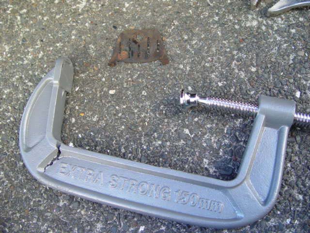

Coz this happens when I wind the clamp down to push the piston back in:

Postby Zak » Fri Apr 08, 2005 5:23 pm
Gotta love the "extra strong" written down the side of that clamp :lol:

Postby Dr-X » Fri Apr 08, 2005 6:05 pm
8O 8O 8O Please tell me you weren't using that on the rear calipers

good effort on that clamp, you must have strong wrists :wink:
Postby sergei » Fri Apr 08, 2005 11:49 pm
I'm sure it says "Made in China" on other side, on good ones I usualy manage bend the lever or screw up the thread on bolt, but not brake like that.
Never buy any tools which says "Made in China" unless you like breaking tools

I'm just upset the vice doesnt say 'exra stong' on it

probably says made in china doesn't that mean its strong? :roll:
