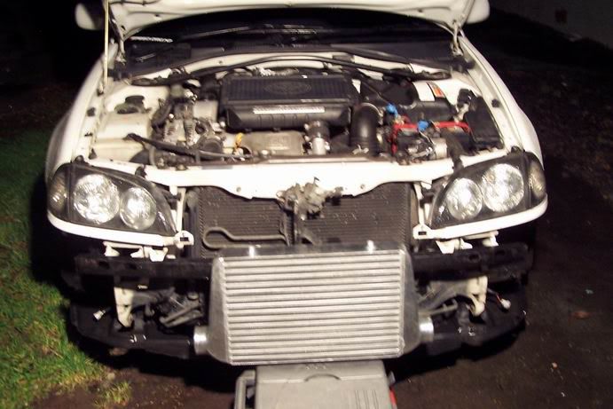

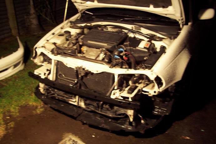

Postby Santa'sBoostinSleigh » Fri Sep 16, 2005 6:42 pm
random pics:
and yes i did decide to pull it to bits in the rain and dark :S

Postby 1598cc » Fri Sep 16, 2005 7:34 pm
cant really see much.

Postby Santa'sBoostinSleigh » Fri Sep 16, 2005 7:52 pm
yeah thats cause its just sitting there, not mounted yet
