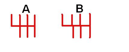

Yeah, after a while they all seem to do that. I have been told that its just the way the gearbox is put together. The 'gate' of the gearshifts are not completely up and down, but slightly off to the side. This, I'm told, is because of the position of reverse.
They look kinda like this:
A: Is what you would think it would look like
B: Is more realistic, which makes it harder to get into 2nd gear.
This is especially hard at high rpm/load, and really pisses me off when I'm racing and I'm going into the hairpin at Puke Track and I can't get 2nd gear!!! :evil:
