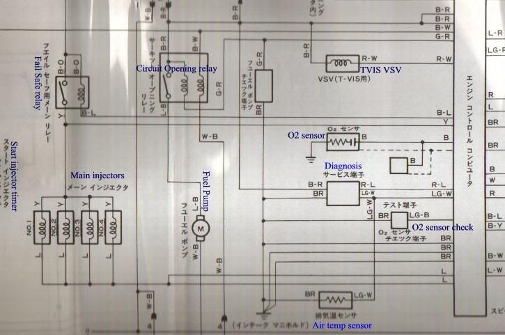

Ill try the LED, there is definately 12v to the injectors but my belief is the Fail Safe Relay is probably coming on. Not sure why.
By the looks of it, from the diagram the computer has the option to short out the injectors to shut down the engine using that relay.

Postby jondee86 » Sun Jul 23, 2006 10:09 pm
Just take a temporary 12 volt supply direct from the battery, or any
circuit switched on by the ignition switch, and stick it up the injector
power circuit. That way it doesn't matter if the failsafe relay operates
or not.
AE86 has an ECU input for that relay, but the AE92 ECU does not. Gave
me no end of grief trying to figure out why the injector circuit wasn't
powering up :?
