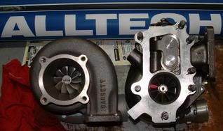

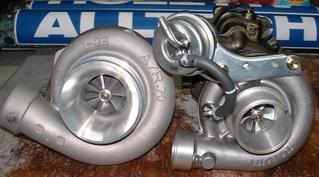

Postby Phothog » Wed Sep 27, 2006 6:30 pm
As a comparison GT3076 1.06 A/r turbine against a New CT20B
Compressor side
Turbine side
this is the turbo i would chose (apart from the 1.06a/r it easy to get at lolol.)
