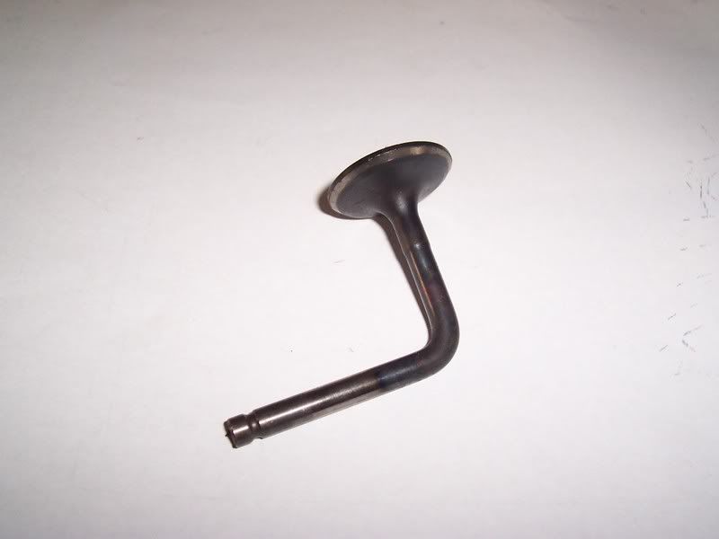

BZG|Bling wrote:sweet to put the valves back in after using method 2?
