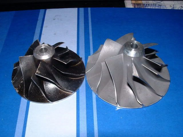

we (Alltech) have done so many upgrades this year on the CT26's
i think we are on to our 6th one now...
pretty simple..
1 x 46trim T04E Compressor wheel (new of course)
1 x Steel turbine wheel & shaft assembly (new of course)
machine Compressor wheel, bearing housing & Compressor cover to suit.
rebuild (Bearings, Piston rings, Orings, etc...)
all up including labour & machining and GST $1,480..
gets rid of the lack of power above 5,500rpm
and bolts back on in place... no mods need to fit...
with any upgrade you dont need to run lots of boost,
say on the above upgrade 12psi will well out do 15 on the stock unit...
(if you start to run over 15psi on the stock turbo you start to go backwards, creating more heat in the air,making the intake temp hotter,
meaning less hp..)
running the turbo "un gated" ... not a good idea
you must have some sort of wastegate if it is the internal or an external gate. or you will over boost. can you say 25+psi of boost on a stock engine, recipe for disater your stock injectors/pump wont cope, & will lean out the fuel if your not lucky good by engine...
as i said when i get to work i'll post a price for the upgrade & some pictures..

and pictures as promised...
the one on the left is a stock CT26 C/wheel from a ST185 Celica / MR2
& the one on the right is a 46Trim T04E C/wheel that has been machined to suit the CT26.
just doing another one now so when that is finished i shall get some before & after pictures... (we now have two other celica Ct26's to do.)
