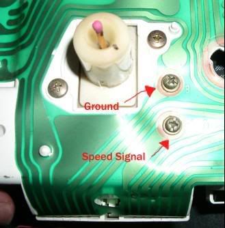

i had the same problem with my blacktop, it was the speed signal not being hooked up, u can get a speed signal from the ae85 dash, i have a pic of it,
failing that then check the codes and see what comes out,

Postby slighty_sykotic » Tue Apr 24, 2007 3:21 pm
frost wrote:i had the same problem with my blacktop, it was the speed signal not being hooked up, u can get a speed signal from the ae85 dash, i have a pic of it,
This guy will be right.
If you havnt got the speed sensor hooked up, lowers revlimit in silvertops (and does far worse in a blacktop...).
Find a 20v factory car, and sit still in netural and rev it up to hit revcut, have a look where it cuts, and then go do it while driving. Fair bit of a difference.

Postby Meadzy » Sat Apr 28, 2007 6:41 pm
Anyone know which pin to connect it to?
