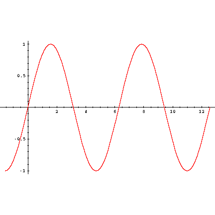

Postby sergei » Thu May 31, 2007 11:40 pm
BTW PWM is not a sine wave ;). sine wave looks like this:
PWM looks like this:
