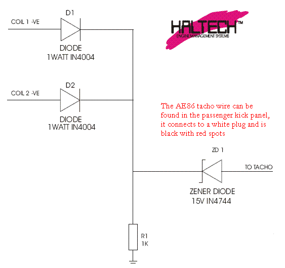

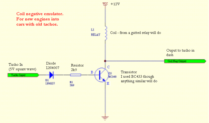

Postby frost » Sat Oct 06, 2007 4:52 pm
should be the ge- on the diagnostic plug i think, if not you can make this to convert the signal this is for 4agze coils on ae86 dash
http://i12.photobucket.com/albums/a216/ ... fix5oh.gif
or this one
http://i12.photobucket.com/albums/a216/ ... tor4ly.gif
Postby bluemaumau » Sat Oct 06, 2007 5:04 pm
when my dash loom was made pins that were not used were removed/cut, all i need to do is find out which pin on which plug on a ae101 4afe is the tacho rpm signal and i caan plug my wire from my tacho interface in, and should be fine.
cheers for the help frost but i know how to get the signal, i just want to know where at the other end it goes!
