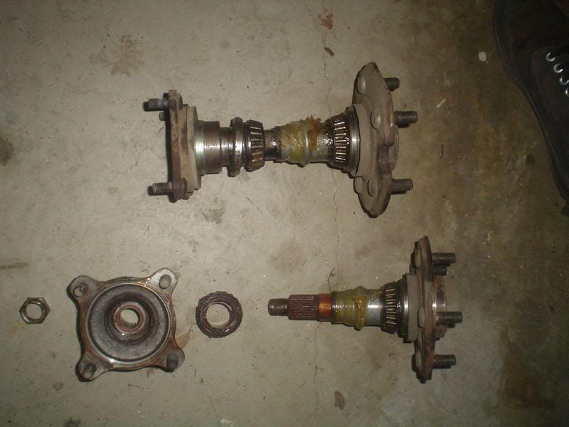

Postby deaf_rattle » Mon Oct 08, 2007 9:17 pm
http://lh3.google.co.uk/william.bevan/R ... C03898.JPG
http://lh4.google.co.uk/william.bevan/R ... C03899.JPG

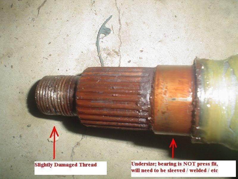

The same hub that has the thread damage also has an undersized bearing locating face, I believe a sleeve could be used to fix this I suspect at not much cost! Spray welding could be another option to repair the hub?....
or i could look at finding a bearing the right size that allows for this.
or should i not touch them?

Postby NZ_AE86 » Tue Oct 09, 2007 7:16 am
If you can not buy new parts at a good price get them 'metal sprayed'
Whatever you do don't put it together as it will $&#$% a new bearing asap!

Postby metric » Tue Oct 09, 2007 2:52 pm
i ended up doing a sleeve on a wheel bearing of mine, if your going pay someone to machine it its not really worth it but if you have the gears at home whats the worst that can happen? you reck it and have to pick another one up anyway!!!

Postby deaf_rattle » Tue Oct 09, 2007 6:17 pm
they are 5 stud hubs, not easy to find.
decided to get them, ill take them in and hopefully be able to find a bearing suitable.
otherwise ill sleave them and use stock bearing.
