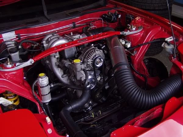

Re: Few questions
Postby barryogen » Wed Jan 09, 2008 4:10 pm
Emperor wrote:dont want the surge tank to run out before the stock pump can put more into it
doesn't the return from the engine normally go to the surge tank?
although that would mean that the fuel would get warmed more.

Postby Emperor » Thu Jan 10, 2008 3:35 pm
yeah just got told that.
but apparentally need to change the intank one anyway, to a low pressure one, and a high pressure after the surge tank.

Postby evil_si » Thu Jan 10, 2008 4:11 pm
in my rx7 im using
standard intank pump to supply the surge tank,
then bosch pump from surge tank to engine,
engine return back to surge tank
and an overflow from surge tank to fuel tank,
if you run the engine return to surgetank you must run an overflow!! you will have no control over fuel pressure if you dont!

Postby IH8TEC » Thu Jan 10, 2008 4:27 pm
or procoating (refer my project) barry has a proper lifter pump that you can buy, it's designed to be able to run dry just in case you do run that low,
i however am using the std gze pump for lifter
-8 main feed (making my own lines, it's easy)
through fuel filter to a bosch o44 external pump
-8 line to engine bay with another inline filter to fuel rail
-6 return to fpr
-6 from fpr to surge tank,
-6 overflow from surge tank to fuel tank
